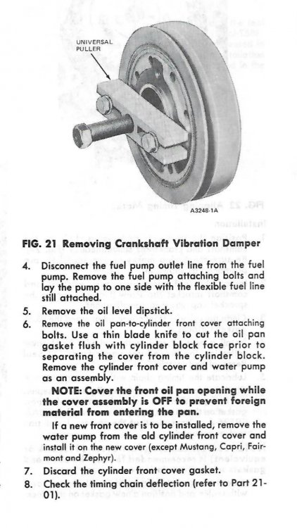

FLYER34 Posted March 12, 2019 Report Posted March 12, 2019 (edited) Ford n'envisage pas que le damper sorte tout seul (d'où ma suggestion d'extracteur ci-dessus) : Edited March 12, 2019 by FLYER34 will2406 1 Quote
