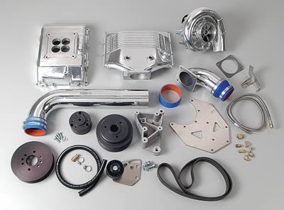

même chose chez Vortech
Image IPB
Tire-shredding power that fits under your hood.
Now you don't have to run a cumbersome roots-style supercharger on your vintage muscle. Vortech's carbureted centrifugal supercharger kits are designed to bring the performance and compact fit associated with late model fuel injected kits to vehicles equipped with carbureted engines. In most cases, these kits will fit under your stock hood without modifications. The heart of each kit is either a gear-driven V-1 S-Trim head unit or a gear-driven V-7 YSi-Trim head unit, unless otherwise noted. The cast aluminum carburetor enclosure assembly pressurizes the float bowls and throttle shafts for seamless response, and is designed for use with Holley 4150 or Demon 750 MD carburetors. The enclosure features front and rear -8 AN fuel inlet ports as well as provisions for pressure and vacuum connections. Linkage arms, a splined shaft, left/right hand spherical rod ends, and carburetor studs are included for simple throttle connection and adjustment. The included oil feed and oil drain assemblies deliver the best possible lubrication and cooling for the supercharger. They also feature a 6061-T6 billet aluminum supercharger crank pulley, pulley spacer, and an automatic belt tensioner.
